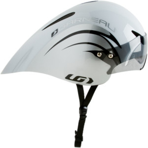

When I changed from a road helmet to a Garneau Prologue 3 years ago, I went a minute faster. When I changed bikes to the dual 650C, I went 2 minutes faster. Those were significant changes.
Larry, you mean Louis Garneau Rocket Air ?
There seems to be quite many interesting helmets from Louis, but not all will work with reclined seat (20 degree or less) and in lowracer...

Prolouge, not Rocket.
Need short, "high" tail so it doesn't contact stuff such as rear wheel.
Helmet is of course worn "not as intended", rotated 90° forward since head is leaning back 45° instead of leaning forward 45°.

I think the best helmet for a recumbent position from Garneau these days is the Vortice. It has a much shorter tail and some other aero enhancements.

plus part of the reason the LG helmet could be better is cuz the newer ones seem to fit tighter to the head.

Sounds like a plan to get one for TT's and serious riding. As tight fit is mentioned, this is likely helmet to be fitted prior to (online) purchase.
Some models are sub-100 $/€ which is not bad considering my current S-Works was just under 200 € with discount...

I thought the same thing. I bought a Vortice and tried it. It was not faster than my regular open vent road helmet - the reason being I had to sit up higher to allow the tail to clear my wheel. This was on my Morciglio M1 lowracer. Also the Vortice, like other helmets tends to be simply too large / wide. On a very laid back seat, the most important thing I think is to have a rounded brow of the helmet for better aerodynamics. Too many helmets have a square cut to them around the brow.
